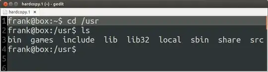

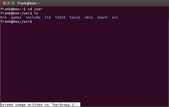

There's a package that's called screen - a terminal multiplexor with VT100/ANSI terminal emulation.
According to the manpage of screen on the Ubuntu Manuals website , screen claims to be
a full-screen window manager that multiplexes a physical terminal between several processes (typically interactive shells).Each virtual terminal provides the functions of a DEC VT100 terminal and, in addition, several control functions from the ISO 6429 (ECMA 48, ANSI X3.64) and ISO 2022 standards (e.g. insert/delete line and support for multiple character sets) a terminal multiplexor with VT100/ANSI terminal emulation'.
and when running screen:
Ctrl ah (hardcopy) Write a hardcopy of the current window to the file "hardcopy.n".
I tried in the GNOME Terminal, running screen and typing Ctrl ah
running screen and typing Ctrl Alt h
This is the output of my hardcopy.1 file when opened in Gedit:
hardcopy.1 opened in Gedit
You can find screen is in the raring/main software repository of Ubuntu 13.04.
It's not installed by default.
Hm, this will not copy the escape codes, but just to grab the text, you can go to menu Edit -> Select All, then press CtrlShiftC and either (i) paste the clipboard to an editor or (ii) type cat > filename and press CtrlShiftV.
