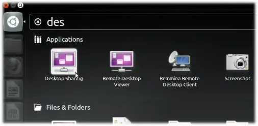

Ubuntu 12.04 comes with Vino VNC server pre-installed (but not enabled). So you can simply use that one without the need to install any other VNC server, it works just fine for most applications.
To enable it:
  1. select "Desktop Sharing"
(or if you use gnome-session-fallback, select in the menu: Applications -> Internet -> Desktop Sharing")

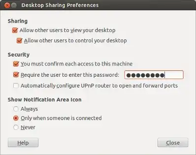

  1. Check the box "Allow users to view your desktop"
  2. Check the box "Require used to enter this password:" and type in your preferred password
  3. Click on "close"
and you are good to go.
You can test this right away by trying to connect from any local VNC client to the IP of your machine. If you are behind a firewall or NAT router, you will need to forward port 5900 to your Ubuntu machine.

If you want to administer your machine remotely, and this may involve restarting, then note: (1) VNC will be available after restart through the VNC client, (2) if the box "You must confirm each access to this machine" is checked, then after restart you or someone else must physically be at the machine to let you connect again. Therefore you should uncheck this box if you want to be able to reconnect from a remote machine after a restart.
If it doesn refresh, try with x11vcnserver. Works for me.
