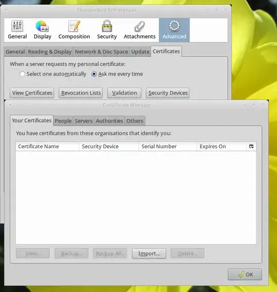

  • You need to import your certificate into thunderbird by going to edit > preferences > advanced > certificates (first screenshot).

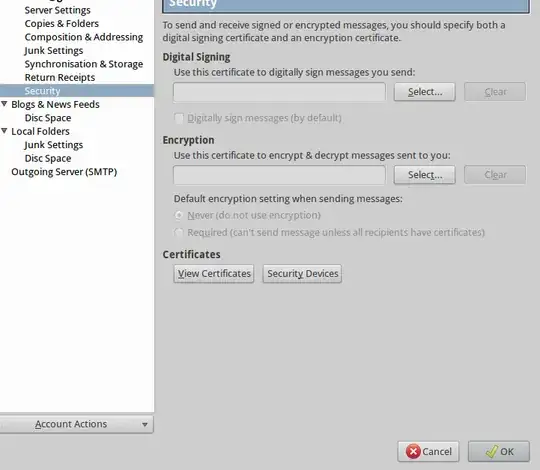

  • You then need to add your certificate to your Thunderbird mail account (see second screenshot) by going to account settings and clicking the security tab. All this is simple to setup and to use once you have your certificate.

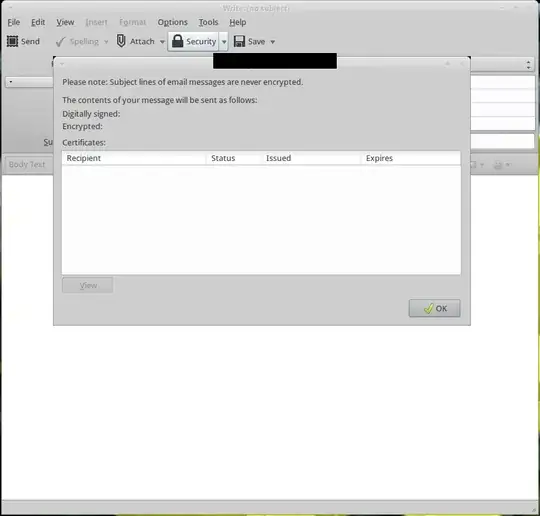

  • The security options are clearly visible when composing a mail (see third screenshot) and you can add your signature or fully encrypt the mail.
