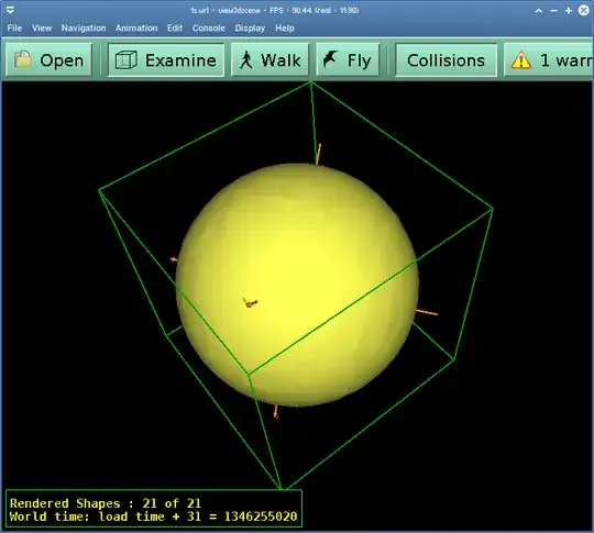

I have never used these files, but after some googling i came up with this site which lists some vrml/x3d viewers. I have tried the InstantPlayer binaries for ubuntu, but I couldn't get it to open the 1s.wrl file from your link.
But the view3dscene worked for me. On this page you can find the binaries for both 32-bit and 64-bit Ubuntu.
It's a bit ugly, but seems to work. Here is what it looks like on my computer: enter image description here
