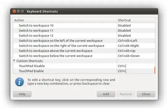

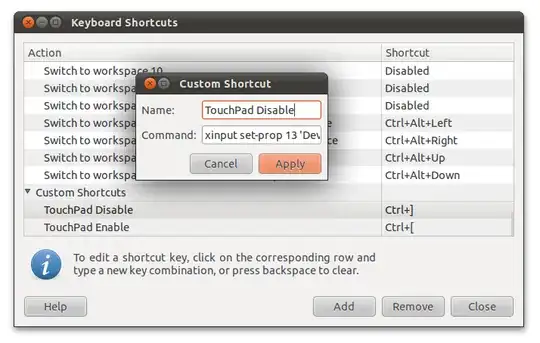

First thing to be done is to know your touch pad id.So to do that follow these steps
First open terminal and Run this command
~$ xinput --list
Here we get this Touchpad id = <id Number>
After that open keyboard shortcuts then add this below two command with your keyboard shortcuts.
# Disable Touchpad:
xinput set-prop <id number> 'Device Enabled' 0
# Enable Touchpad:
xinput set-prop <id number> 'Device Enabled' 1
