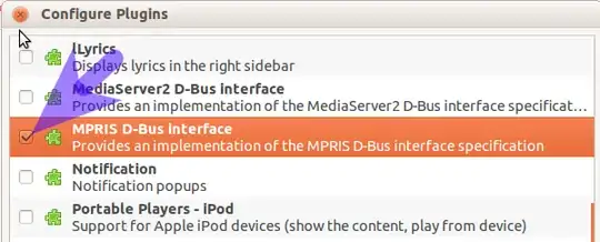

rhythmbox-client uses a process communication protocol called DBUS. Its the same protocol that the Unity Sound Indicator menu uses.
You need to ensure that this plugin is enabled in Rhythmbox

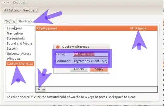

How to I assign a short-cut key...
Launch Keyboard from the Unity Dash.
The important part is the command and assigning the short-cut itself.
The command you need to use is rhythmbox-client --play-pause

Launch keyboard in Unity Dash Go to shortcuts
Go to Sound and Media
How it looks in 18 lts
Change the key shortcut for play/pause to Ctrl-Space (in your case). You can also change the other keys here.
