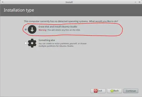

When booting into the Ubuntu Studio install disk and installing Ubuntu Studio. It will give you several options on how to partition the disk before installing.
You will want to select the option "Erase Disk and Install Ubuntu-Studio"
Ubuntu Studio Install Partitioning screen
Your installation will probably not show "This computer currently has no detected operating systems." That's just because I didn't fully replicate the scenario in my virtual machine.
That will clear the hard drive and make Ubuntu Studio the only operating system on the disk.
Warning: This will also erase all data on the hard drive. Please backup anything important to an External hard drive.
