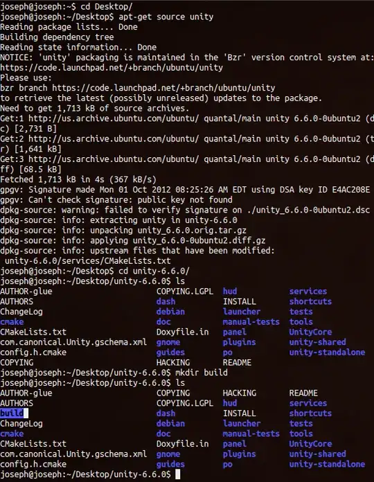

1st) get the source code. we can make a place to build from , for this example I will use
~/Desktop/
get the source code
cd ~/Desktop
apt-get source unity
This will get all the source code, Or you can use bzr to get it
bzr branch lp:unity

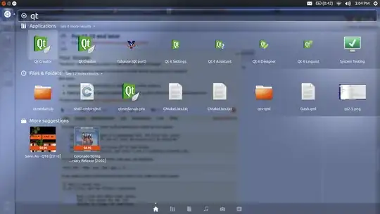

Next We open up Qt Creator,
Now We can open up are project (Unity in this case) But before we do this lets make a Build dir So
cd ~/Desktop/unity-6.whatever
mkdir build

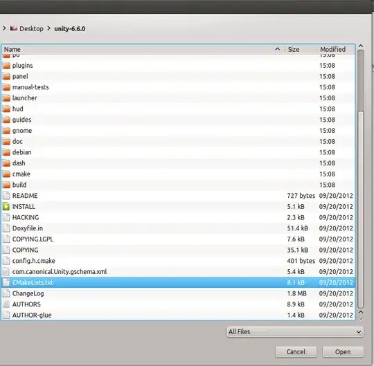

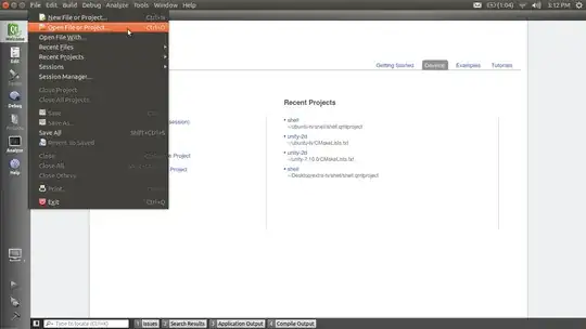

Now in Qt Creator we can open Unity . Go to File->open file
Next we will be asked what file we want to open up. We want to open CMakeList.txt

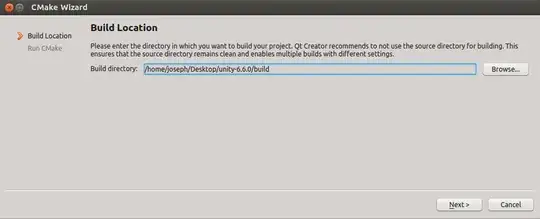

Next We will be asked what Build Directory we would like to use. This is why we set up the build dir in the projects top level. IE ~/Desktop/unity-6-whatever/build
And this is the Directory that we will choose Then we Press Next

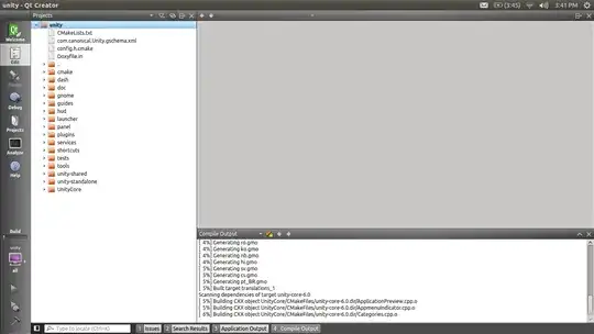

If all goes well it should set up build files to ~/Desktop/build as shown in the screen-shot

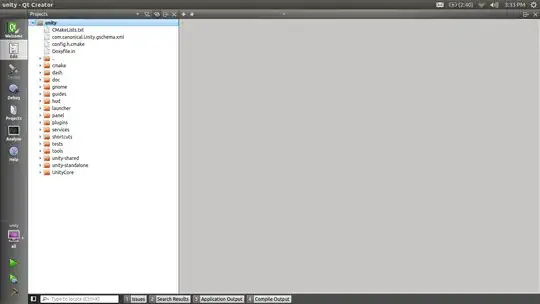

We can now Press the Finish Button. And We will get a screen that looks like this.

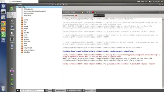

Now to build Unity and test are results. The first thing that we need to do is tell Qt-creator what we want to run after compile. We do this by clicking in the Icon that looks like a monitor and then select
unity-standalone
NOTE: There are some issues with unity stand alone and it will not run as fast nor will it render graphics as good as when installed. But when you install on to system all will be ok. I am also unsure when Unity started using Unity-standalone as before 5.10 I was a Unity 2d kinda guy :)
Now we can Run Unity press ctrl+r (keyboard shortcut) to run and Unity will compile.
Or we can press the green arrow button also in QT-Creator to Run
Well Compiling (Running) We can watch to see what is going on by pressing the
Compile Output Button

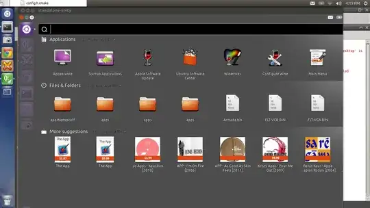

Once compile is done (takes a minute) Unity-Standalone should launch
Now we can play around with the Unity that we just built Go back to QT Creator and and Press the stop button. To Kill Unity-Standalone

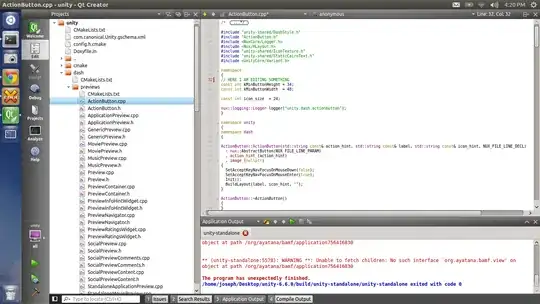

Next we can start editing files if we like to make Unity more how we like
After editing we press ctrl+s to save are work then Run it again ctrl+r
