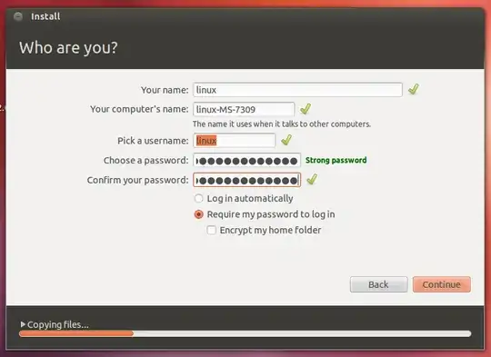

What you ask is almost a normal setup. During installation you get asked to insert a password and can choose to have that user log in automatically. This image shows the checkbox as off (You can not use automatic log in with an encrypted home).
After install you can still set this at the accounts settings:
The screen lock is by default set to ask for a password. Have a look at this topic for more information: How do I disable the screensaver/lock? on where to find it. The setting where you can do this looks like this:
It is about not setting the lock but you just have to set it the other way.
