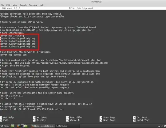

I have give a detailed answer from top to bottom. You might want to skip to middle of my answer or just refer the screenshots below for understanding it in a glance.
You need to configure ntp with servers as follows:
You should at least set following parameter in /etc/ntp.conf config file: server
For example, open /etc/ntp.conf file using nano text editor:
  sudo nano /etc/ntp.conf
Locate server parameter and if it is empty set it as follows:
  server pool.ntp.org
But usually In ubuntu already some servers are prewritten which might be
server 0.ubuntu.pool.ntp.org
server 1.ubuntu.pool.ntp.org
server 2.ubuntu.pool.ntp.org
server 3.ubuntu.pool.ntp.org
Save the file and restart the ntpd service:
   /etc/init.d/ntpd start
