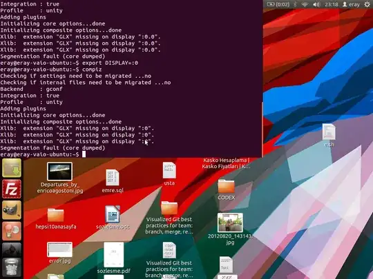

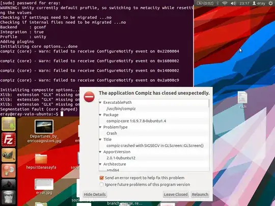

I tried unity --reset after this, i get Compiz closed unexpected error.

I just reinstall my Compiz. Now i don't get COMPIZ error when unity --reset
