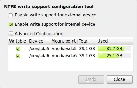

  • Install ntfs-config Install ntfs-config
  • After installation you can access it under System > Administration > NTFS Configuration Tool.
  • Select the appropriate drive you want to get mounted.
    alt text
Also see this post.
