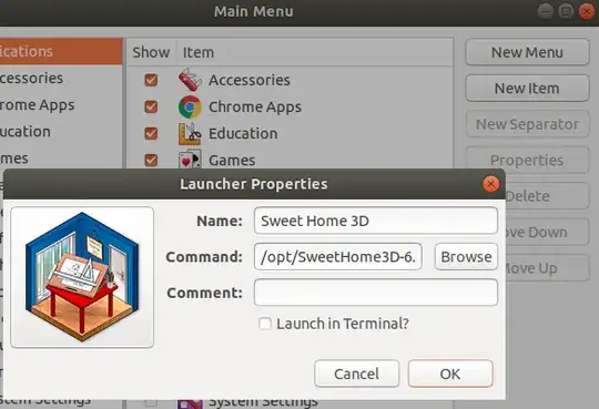

    • Create icon:
      • Alt+F2, Run alacarte
      • Clic on New item and create it: screenshot
