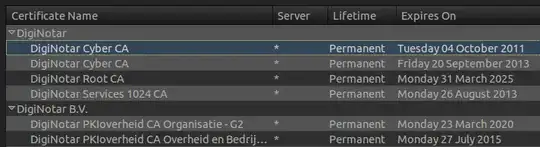

    And you don't have to worry about that. DigiNotar is Not Trusted by Default. To see, select the Edit trust option under it. So it is as good as non-existent. Just make sure that the option Ask me Every time option is selected.
    Dialog image

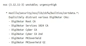

  3. To confirm, the Security team did address this issue here under version nss (3.12.11-3) unstable; urgency=high stating it as Explicitly Distrust not Deleted, whereas current version stands at nss (3.13.1.with.ckbi.1.88-1ubuntu6.1) precise-security. So you don't have to worry at all.
    Changelog
  4. Actually there are two Certificates menus in Certificate Manager as Server and Authorities. DigiNotar is present in my Server section, the first listed one is Expired, need to delete it manually.
    Certificates
