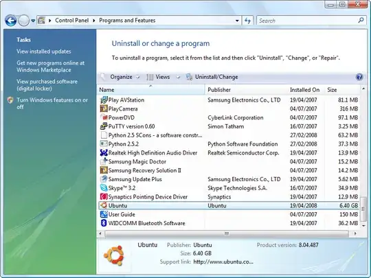

First of all, check the uninstall programs sections of the control panel. You may find that it is still there to uninstall. If not, that is fine, just continue to the next section (past the horizontal rule)
Programs and Features with Ubuntu highlighted
Trying uninstalling with the default uninstaller again and see if that works.

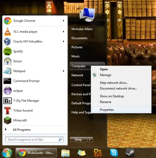

  2. Click on the Start Menu, right click on "Computer" and click "Properties". (You can also goto "Control Panel\System and Security\System" in Windows Explorer.) Start.Computer, Properties

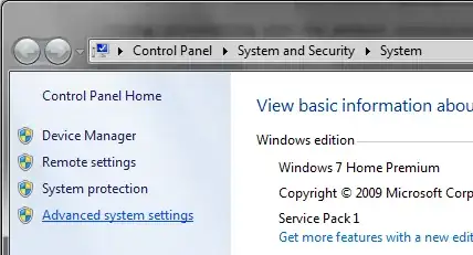

  3. Choose "Advanced system settings" from the left. Advanced system settings highlighted in Control Panel\System and Security\System
