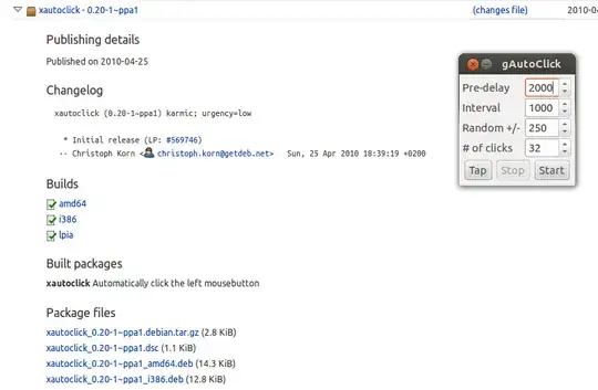

I went to this page and downloaded the xautoclick_0.20-1~ppa1_amd64.deb (14.3 KiB) and it works great :D
Thanks to Kat Amsterdam for finding xautoclick

In Lucid 10.04 LTS
  1. Open Ubuntu Software Center
  2. In the search box, type in autoclick
  3. Download xautoclick
    For Precise 12.04LTS the package has been removed from the Ubuntu Repositories and is only available via GetDeb.
    xautoclick instructions for install in precise
    or via Christoph Korn's PPA (who is a member of GetDeb):
    sudo apt-add-repository ppa:c-korn/ppa
  4. Download xautoclick via the software center (or if you are handy with the terminal)
    sudo apt update && sudo apt upgrade && sudo apt install xautoclick
  5. Read the instructions on xautoclick man xautoclick
  6. Under Programs, Accesories choose xautoclick
  7. Change the Interval to 5000 (the value is milliseconds)
  8. Click Start
  9. Move the mouse over what you would like to click
  10. Enjoy!
