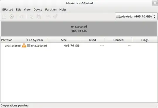

When I start the Live CD, I can see that gparted does not detect them: enter image description here

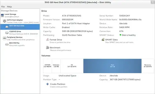

But the disk utility can: enter image description here
