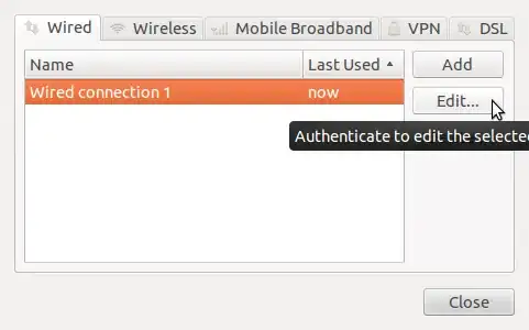

To add a static DNS server, first you need to edit your network connections.
Edit network connections
Next, edit the wired connection
Edit wired connection

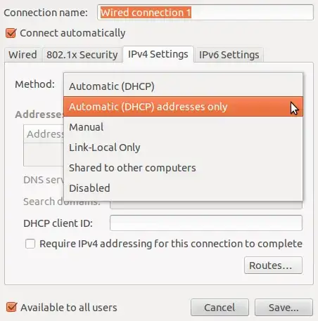

Next set it to only get an IP address from DHCP

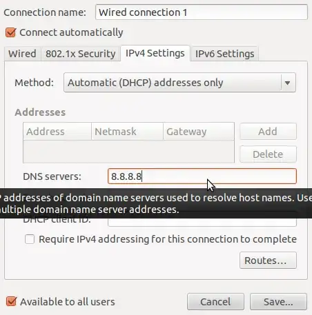

Addresses only
Last, enter a working DNS server. 8.8.8.8 is a google DNS server that you can use. If you want to add multiple DNS servers here then just separate the IP addresses with a comma.
Add DNS
Once you've added the DNS servers, click save until you get back to the desktop. You should then be able to browse the internet.
