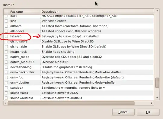

If you want to fake having it installed, try : winetricks
alt text
If this isn't working, I can't help you much, except to suggest installing with playonlinux and then replacing your wine prefix with the ie's prefix, but that would mean you have to reinstall everything.
