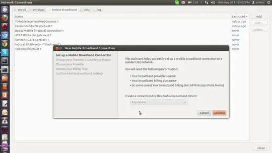

is it mobile broadband modem ? as what i know you need to go to network connection - edit network and go to the mobile broadband and click add.. there you need to setup where are you from to get the list of provider from your country
here the screen shot
and adding more information if you like to have auto connect Ubuntu 12.04 USB GSM Mobile Broadband Connection .. i hope this link help you .. http://www.thefanclub.co.za/how-to/how-auto-connect-ubuntu-1204-gsm-mobile-broadband-connection-on-boot-startup-service
