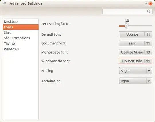

The most important issue is, that the ideal would be that when setting system fonts, what I want to do is be able to specify a default English font and a default Japanese font. The only place I've found to specify system fonts is here under System Tools -> Preferences -> Advanced Settings:
The problem is that it doesn't differentiate between English and Japanese font displays.
