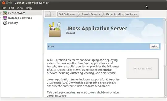

Jboss is available in the software center.
alt text
But the version is still 4.2.3.GA-2
