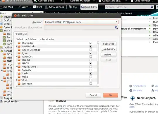

In Thunderbird, when we Right Click on Inbox or any of the Folder Entries in the Left Panel, we get a Subscribe Option in the Context Menu.
Using this we can subscribe to a select group of folders among all the available folders in the Mail Account.
By doing so, Thunderbird checks for New Mail, only in those folders, and the indicator responds to new mail only in those folders.
