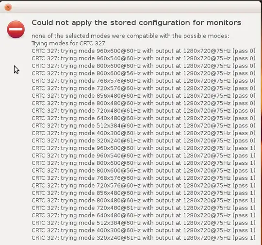

When I unplug the computer from the television, and plug it into the monitor using the VGA to VGA cable, without turning off the computer, Ubuntu appears on the monitor with this error ;

After reconnecting the computer to the television and then booting the computer up, I still receive no video signal, only a black screen.
When reconnecting the computer back to the monitor, a CRTC error is showing up on the screen again.
