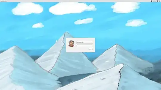

I have Written a small script to make it simple. I am sharing it here.
Install Step 1: Save this code into your home directory a file named loginsceenshot.sh
## Save this file in your home folder loginscreenshot.sh
## make the file Executable
## Hit Ctrl+Alt+F1
## login and run program using
## sudo ./loginscreenshot.sh
echo "Waiting  .... "
echo "Now Go to Ctrl+Alt+F7"
sleep 15
echo 'Click ...  '
DISPLAY=:0 XAUTHORITY=/var/run/lightdm/root/$DISPLAY xwd -root > tmp.xwd
rm tmp.xwd
echo "ScreenShot is Taken, Please check your home directory and open 'ScreenShot.png'"
Install Step 2 Hit Ctrl + Alt + F1, login, and type this.
chmod +x ./loginsceenshot.sh
sudo apt-get install imagemagick
Use Step 1 Hit Ctrl + Alt + F1, login, and type this.
sudo ./loginsceenshot.sh
Use Step 2 Hit Ctrl + Alt + F7, goto Login page and wait for 15 sec.
Myhomescreen
