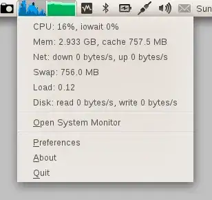

You can possibly use indicator-multiload.
Install it from the Ubuntu Software Center or using the command line:
sudo add-apt-repository ppa:indicator-multiload/stable-daily
sudo apt-get update
sudo apt-get install indicator-multiload
You can configure some of the things from the Preferences.
for indicator-multiload you can also add cpu freq:
Preferences -> Menu items -> add
$(frequency(cpufreq.cur0)) - $(percent(cpu.cpu0.inuse))
$(frequency(cpufreq.cur1)) - $(percent(cpu.cpu1.inuse))
etc...
