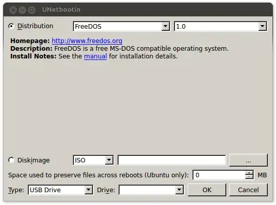

Install UNetbootin in the Live CD and select FreeDOS as the distribution, which will download a 1.44 MB boot image and create a DOS boot disk for you. UNetbootin is also available for Windows
Unetbootin showing FreeDOS as selected option
If you're curious the image is named ubninit and can be mounted in linux:
