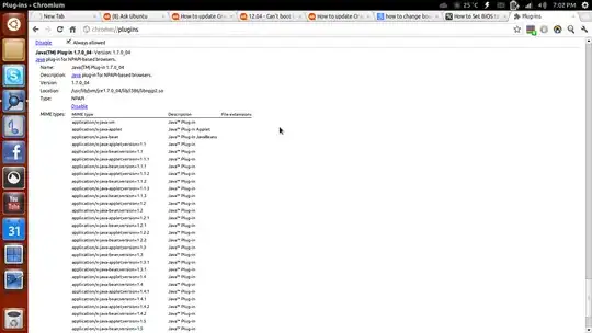

Download this shell script from here .
Give it Executable permissions. Once you open it will show a list of software. Select Java. It will ask If you want to install openjdk or Sun Java. Select whichever you want. It will work its charm and you're done.
Once you do that this what you will get

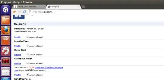

I had the same problem and solved it by cleaning the Chrome cache.
You enter
chrome://chrome/settings/clearBrowserData
on the navigation bar. Then check only "Empty the cache" and "Delete cookies and other site and plug-in data" and then click on "clear browser data".
