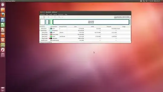

I have installed Ubuntu 12.04LTS and I am trying to recover files off a failing HD that is 400GB. The drive I am trying to copy to is 500 GB but I have Ubuntu installed on the same drive.
See the image to understand my partition setup (yes it just might be ridiculous but I'm a noob)
Anyway.. I want to be able to copy my 400 GB HD (contains a vista installation) to this 500 GB HD in the sda8 partition. Does that make sense? Also I want to be able to eventually access these files via another vista installation. I just want to get them off the other hard drive which is basically failed (so this might all be moot).
When I created the sda8 partition I didn't choose a format: does this matter?
It would be really nice if the 500GB still had a usable Ubuntu on if after the transfer and that I would eventually be able to see the recovered files in a future vista install. Can you guys help?

You could try to replicate your partition setup in a bigger drive but you can't do it into a partition. You need to recreate the partitions in the new drive creating one partition per partition recovered with the same size or slightly bigger, then copy from the old to the new partitions. The 'dd' command can read and write data directly from/to partitions.
Another solution could be making TAR or ISO archives with the content of each partition, these could be accessed from any OS, but you couldn't boot from a OS stored in any of the archives.
Bernat
gparted can copy/paste data from one partition to another - have you tried that? (right-click on an unmounted partition - it's in the context menu.
Using Gparted, you can copy data between partitions, with some constraints. You have to mind the size of the target and destination, and the destination has to be a contiguous partition. Just right-click the partition(assuming it's unmounted) and select the correct option from the context menu.

Try clonezilla and use it to clone your Vista partition onto that 400GB partition you have. This will allow you to copy our Windows installation with unaltered hierarchy. It'll still be bootable (after reinstalling bootloader and recreating BCD entries, which can be done using Startup Repair from Vista boot DVD) and you'll keep all the permissions and NTFS links intact.
