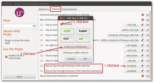

  3. Type "Unity" in the filter box on the left, and click on the Ubuntu Unity Plugin:
  4. Click on the Switcher Tab on top, and
    • Look for the Key to flip through windows in the switcher entry near the bottom (scroll down if necessary)
    • Click on the Disabled button next to it
    • Check the Enabled box on the "Edit Key" popup
    • The keys will show, and click on the Grab key combination button
    • Press the keyboard shortcut combination you do want to use and this will appear beneath the box.
    • Click on OK, and this shortcut will now show in place of the Disabled button
    • The Alt+` is now remapped. To do the same for the reverse Alt+Shift+` shortcut, repeat step 4 for the Key to flip through windows in the switcher entry, or you can just leave it disabled.
Finally, close CCSM and if you no longer need it, please consider uninstalling it.

in ubuntu 14.04 you also need to disable in ccsm->desktop wall->Bindings->Move within wall->Move next
