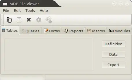

You can try to install mdbtools and mdbtools-gmdb in order to get the mdb viewer for gnome.
I haven't used it myself, so i don't know if it's able to let you edit the database, but it gives you the option to export it, so maybe you can convert it to the oo-base version (odb).
