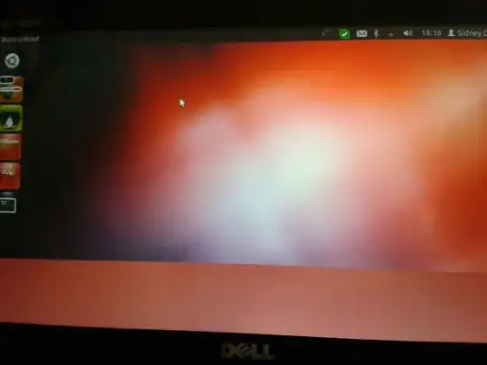

I have a problem with suspend on Ubuntu 12.04 running on my Dell Mini 1010 (with a GMA500 aka Poulsbo graphics card). After suspend (e.g. closing the lid), the graphics are corrupted as shown in this picture
How can this be fixed?

It seems solved at
https://wiki.ubuntu.com/HardwareSupportComponentsVideoCardsPoulsbo/ .
Please see option 1 and 2 if issue is common or subject Fix suspend.
