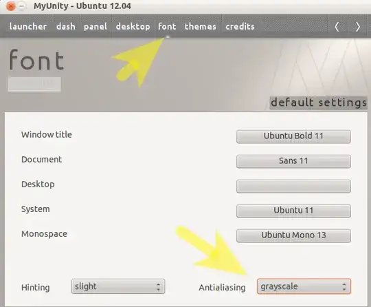

This is currently being tracked as a problem with RGBA anti-aliasing.
It can be resolved by changing the aliasing value from RBGA to grayscale.
Use MyUnity (available in the software-center)
Alternatively, you can similarly use ubuntu-tweak which you need to install from the authors PPA.
