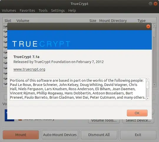

The latest version of TrueCrypt works perfectly on Ubuntu 12.04 and all later versions of Ubuntu provided that you install all of its required dependencies. In Ubuntu 12.04 and later, open the terminal and type.
sudo apt-get install bzr libncurses5-dev gcc debhelper devscripts dpatch
Then install TrueCrypt the usual way with tar xzvf truecrypt*.gz followed by either ./truecrypt-7.1a-setup-x64 (for 64-bit OS) or ./truecrypt-7.1a-setup-x86 (for 32-bit OS).
