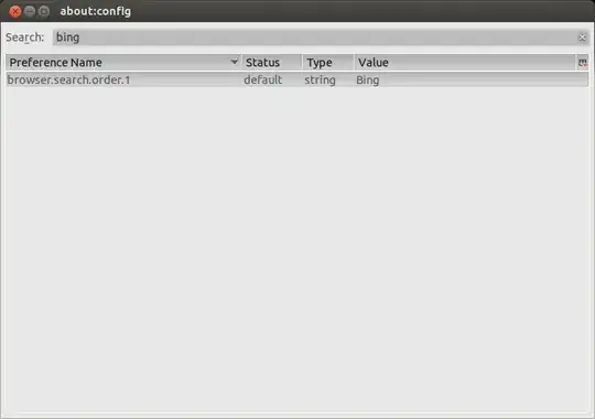

Another possibility (one I've not tested in a fresh thunderbird installation) is to access the about:config editor in thunderbird, and remove references to 'bing'.
To paraphrase the related knowledge-base article, access the editor via "Edit -> Preferences -> Advanced -> General -> Config Editor (button)" .
From there, you can click on the "value" field to change it.
about:config screen
