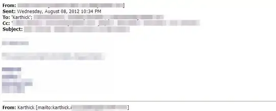

Outlook Screenshot:

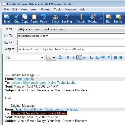

  • Outlook express / outlook has a nice look on forwarding mails. Like it highlights the From field in light grey color. Pls find the snapshot below. How to get this style in thunderbird on forwarding mails?

  • Can i have the below style? All the informations should be highlighted in light grey color, like the one on screenshot below. Also i dont want the email id to be displayed, on mouse over it should show the email id like outlook. You can find it in below screenshot.

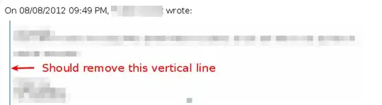

2. Configure ReFwdFormatter to remove the quote vertical bar
  • Go to Tools...Add-ons and select the Extensions option in the left sidebar.
  • Click on the Preferences button for ReFwdFormatter:
  • Make sure all the choices you need are selected, and close.

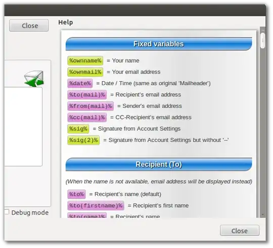

  • To see what the fields mean and a list of all available fields, click on the Help button to expand the window with this useful section (or see list on website):

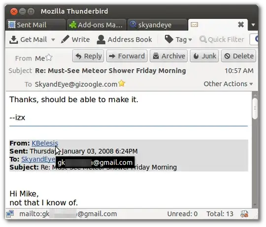

4. Demo:

Specific customizations for karthick87
  • Makes horizontal line blue
  • Makes header font size smaller
  • Gray highlight/background for headers
  • Date/time in Outlook format
  • Only email names displayed in headers, with clickable mailto: links and a tooltip displaying the email address on mouse hover
<br>
<hr style="color:#62B3FF">
<div style="background-color: #DDDDDD; font-size:10pt"><b>From:</b> <a title="%from(mail)%" href="mailto:%from(mail)%">%from(name)%</a>
<b>Sent:</b> %X:=sent% %A%, %B% %d%, %Y% %l%:%M%%p(3)%
[[<b>To:</b> <a title="%to(mail)%" href="mailto:%to(mail)%">%to(name)%</a>]][[<br><b>Cc:</b> <a title="%cc(mail)%" href="mailto:%cc(mail)%">%cc(name)%</a>]]
<b>Subject:</b> %subject%</div>

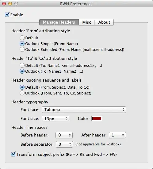

There is an alternative to SmartTemplate4 add-on for Message Attribution aka Outlook like reply in Thunderbird. ReplyWithHeader brings capabilities of outlook like message attribution, header typography, line spaces for Thunderbird. https://addons.mozilla.org/en-US/thunderbird/addon/replywithheader/.
RWH Preferences screenshot: Preferences Screen
Disclaimer: Author of ReplyWithHeader add-on.
