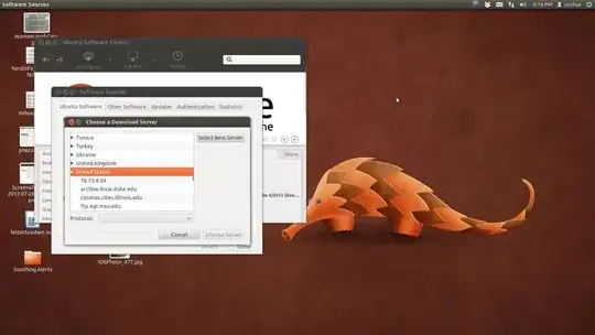

Okay try this:
Open up the Ubuntu Software Center and click on Edit < Software Sources
Once that dialog opens click on the pull down menu that says "Download From" and select other, another dialog will open, click "Select Best Server" your computer will run several tests, and then select the best server based on those test.
This usually fixes the problem for me.
