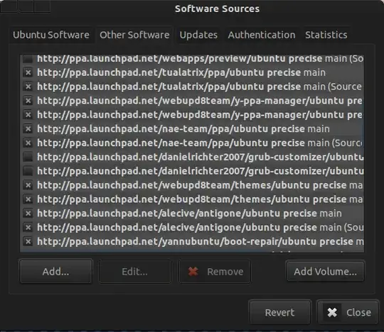

To remove the Gnome 3 PPA open software sources from Dash or through update manager in settings menu , then go to as image and remove or delete the gnome 3 ppa listings manually ( i don't have it :P ). Then do sudo apt-get update && sudo apt-get upgrade and install gnome shell as above command.
