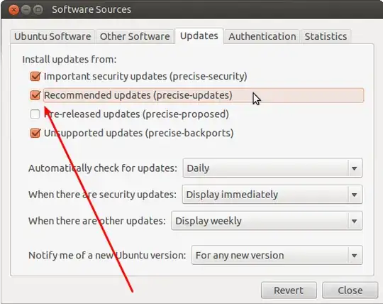

What I do now.
Make sure you have "Recommended updates (precise-updates)" activated as software source:
Screenshot of "software Sources"
then run
 sudo apt-get update
 sudo apt-get upgrade
