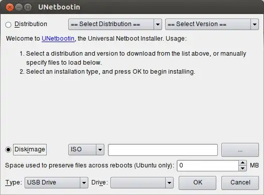

Using Unetbootin
Edit: Although the screenshots are from Ubuntu, they won't differ much in Fedora (except for the look, ofcourse). They are given just for reference.
  1. Install unetbootin.
    sudo yum install unetbootin
    OR you can get it from their website.
  2. Install syslinux and p7zip
    sudo yum install syslinux syslinux-extlinux
    sudo yum install p7zip p7zip-plugins
  3. Execute unetbootin
    You should access it this way if you've downloaded it manually, from the website.
    sudo /<path-to-the-executable>/unetbootin
    If you've installed it from the repository.
    sudo unetbootin

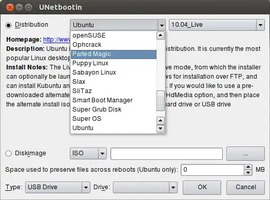

  4. If you've already downloaded the ISO, select the iso and the flash drive and click OK.
    You can also select the distribution and the version, if you don't have the ISO. Although the list may not be updated, so it is recommended that you download it directly from the distro website.

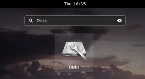

Step 1. Open Disks
Open gnome-disk-utility by Going to "Activities" and searching for "Disks".

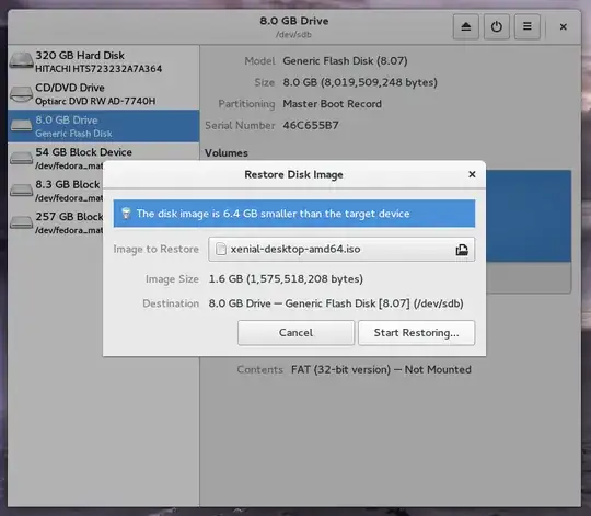

Step 3. Choose image to restore
Use the file selector to find the image (ISO file) you want to write to the USB stick. Click "Start Restoring..." and then "Restore" at the confirmation.

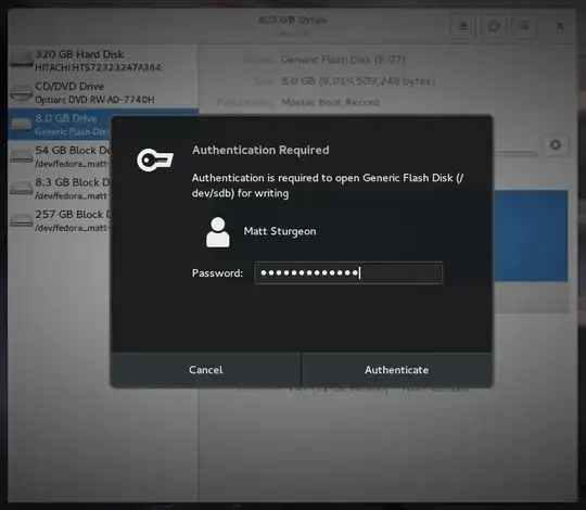

Step 4. sudo password
Enter your password to grant root permissions to Disks and hit ENTER on your keyboard.

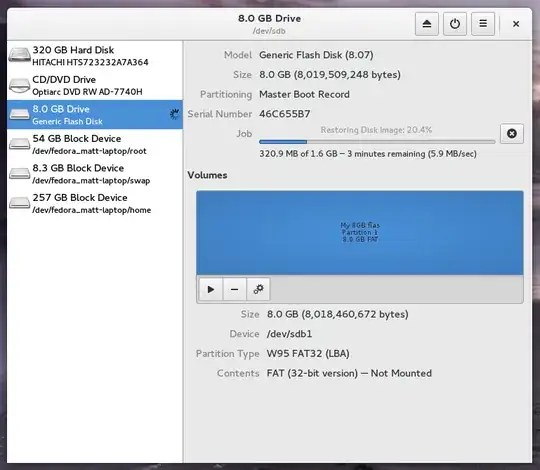

Step 5. Wait. Patiently.
Wait. Patiently. (At least you get a progress bar! Those poor dd users...)
