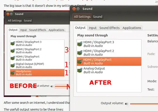

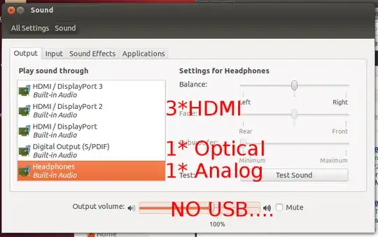

The big issue is that it doesn't show in my settings -> Sound.

EDIT (Once again..)
After
gksu gedit /etc/modprobe.d/alsa-base.conf Change options snd-usb-audio index=-2 to `options snd-usb-audio index=1
Then plug in your headset again.
I lost the Digital output and my headphones became output:
user@ChrUbuntu:~$ modprobe snd-usb-audio
FATAL: Module snd_usb_audio not found.

Waza_Be
  • 105
It seems to me that you are using a custom kernel, since linux 3.2.7, as listed in your uname -a output has a higher version number than the current release 12.04 kernel (3.2.0-29). (It's also lower than the current 12.10 kernel).
Looking at the output of lsmod we can see that there is no module snd_usb_audio in the list of loaded modules. You need that to run most USB audio devices that use the USB standard for audio devices.
The locate command lists several snd_usb_audio modules, but not for your running kernel.
  • I'd suggest you use a standard kernel and see if that doesn't detect and support your headphones.
  • If you have compiled the custom kernel yourself, you may wish to make that work, I'd suggest making snd_usb_audio a module by changing the corresponding kernel config variables, recompile the kernel, and run make modules_install as well as make install to reinstall the remade custom kernel. I recognize that this kernel may have snd_usb_audio linked into the kernel, in which case I don't know why the custom kernel isn't using it properly to install the necessary audio devices.
CONFIG_SND_USB=y
CONFIG_SND_USB_AUDIO=m
John S Gruber
  • 13,436
Based on the lsusb -v output, the Linux kernel's ALSA subsystem snd_usb_audio should be allocating the control and pcm devices for your device and drive them.
Looking at this post, it might be worth trying that solution:
If this doesn't work, please run lsmod and put the output in your question.
If snd-usb-audio doesn't appear in the list please try modprobe snd-usb-audio, and capture /var/log/syslog from when you do. At that time please also check lsmod and /proc/asound/devices and /proc/asound/cards and look for the interface again.
John S Gruber
