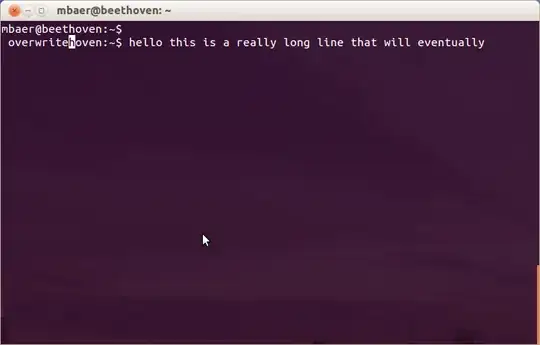

In a terminal window any smaller than fullscreen, if I type in a long command it starts overwriting the current line I'm on. If I type an additional line's worth, it finally moves to the next line. Does anyone know how to fix this?
This is what happens visually:
terminal screenshot

For some reason the terminal size is mis-reporting. It should change when you resize the terminal.
Try this in your .bashrc command file:
# check the window size after each command and, if necessary,
# update the values of LINES and COLUMNS.
shopt -s checkwinsize
10
I found the answer here. The answer with the most votes solved it for me.
To sum it up I had to wrap my formats in \[ \]
export PS1='\[\033[1;32m\]$(whoami)@$(hostname): \[\033[0;37m\]$(pwd)$ \[\033[0m\]'
