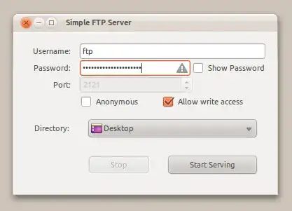

I've also written a little gui for it:
alt text
  • Download it here (updated at rev. 6)
    I'm sorry it's 3999 lines long, but it will do everything the original does. And i wanted to keep it all in one file. When it's started without any parameters (i.e. make it executable and double click it, or create a launcher for it), it starts a little gui for you to configure your server. You can still import it as a python module or use the above command line fu.
