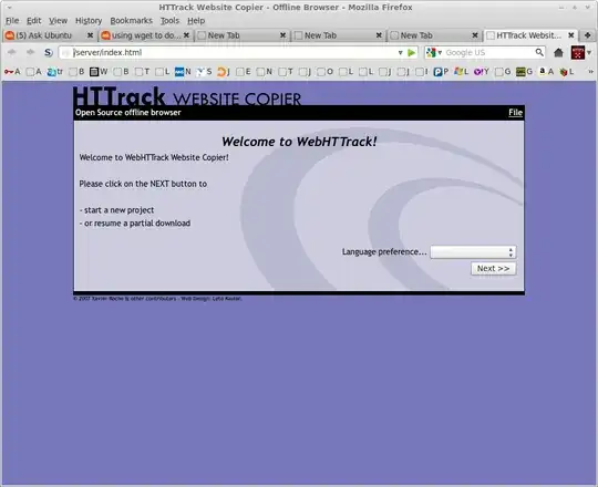

If wget is unsuccessful and you can't grab as much as you want, I should try the command line program httrack or its web interface, webhttrack, which are available in the repositories. There are a large amount of options for this program, but it is better for downloading whole websites or parts of websites than wget. Webhttrack gives you a wizard to follow for downloading a site (it opens in your browser) as the screenshot below shows.
Httrack
