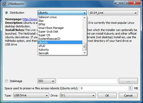

  1. Here's the 11.10 i386 ISO you need for your Mini:
  2. Use Unetbootin to "burn" the ISO to a USB.
    • UNetbootin looks like the above screenshot BUT you select the DiskImage option at the bottom and use the ... button on the right to select the ISO you downloaded in Step 1.
  3. Boot from the USB, and select the "use entire disk" option in the Ubuntu Installer to wipe out 12.04 and install 11.10 over it -- that shouldn't give you any problems since 12.04 will be completely erased.
