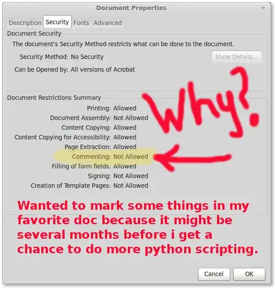

I have a PDF file, and I'd like to comment in adobe style. Is there a way to enable that somehow, or are there any alternatives?

It might be a licensing issue.
Linux Adobe Reader 9 Document Properties --> Security Tab --> "Commenting: NOT ALLOWED"
Even thought the PDF has no security, commenting is still NOT allowed. Might be a licensing issue since the original was created using open source tools, not Acrobat.
"PDF Producer: Apache FOP Version 1.1" -- Commenting Not Allowed.
"PDF Producer: Adobe LiveCycle Designer ES 10.0" -- Commenting Works.
https://stackoverflow.com/questions/18894689/adding-enable-for-commenting-adobe-reader-using-acrobat
http://support.itextpdf.com/node/24
Platform: Linux Mint with Adobe Reader 9.
