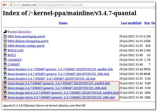

There is no official version of kernel 3.4.7 for Ubuntu. The Ubuntu kernel team produces unofficial "mainline" builds for testing purposes only, but for kernels 3.4+, they are doing it for Ubuntu 12.10 (quantal) only.
Before proceeding, please make sure you read and understand the answer to this question: Should I upgrade to the "mainline" kernels?
You can get the 3.4.7 mainline kernel from http://kernel.ubuntu.com/~kernel-ppa/mainline/v3.4.7-quantal/.
  • Install both the generic and the extra packages for your i386 architecture:
