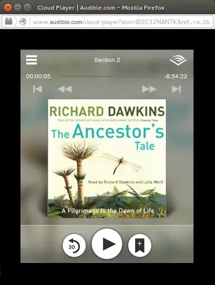

Note: this solution has been originally tested for Ubuntu 14.04 LTS with Firefox 42.0. I tested it again with the new Firefox Quantum 57.0.4 64 bit (still Ubuntu 14.04 LTS) and it still works. Other users are reporting that the cloud player is not working on later versions of Ubuntu with different browsers.
Audible made available a cloud player allowing subscribers to listen to their audio-books library from a web browser.
I tested it on Ubuntu 14.04 LTS with Firefox 42.0 and it worked nicely. In order to open the cloud player, from the homepage, just go to your Library. There you will find the list of your books. Under the cover of each book you will find the Play button, just click on it.
Note: as cloud player, you cannot use it when offline. Hence, not an ideal solution but it is an improvement.
Audible Cloud Player
My Library - Play Button

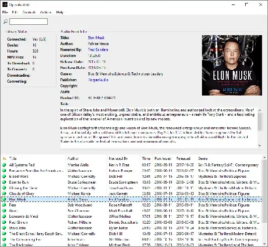

I use OpenAudible. It is a simple, and easy-to-use software which you can use to convert audible files to .mp3.
https://openaudible.org/
