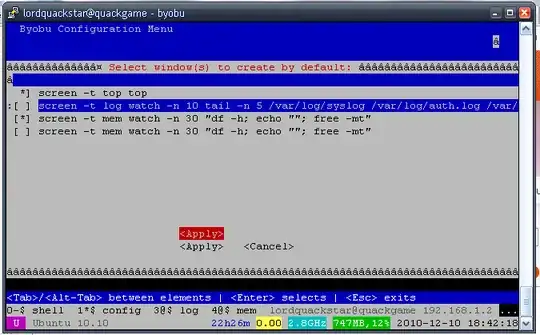

Byobu looks very broken in PuTTY. I've already fixed the key mapping issue, but this issue isn't specified in the man page or even Google:
Broken PuTTY Console
Notice the misplaced position of the list of windows, the broken selector position, the duplication of the last window, the random a in the top right, and the misplaced apply option. You can't see this, but the last option is not selectable.
Is there some option in PuTTY I need to use in order to see this correctly?

Configure putty to read utf8. putty -> config -> window -> translation choose utf in "Recieved data in ..." This is not a byobu issue, it is a putty issue.

Ubuntu uses UTF-8 for its terminal, but byobu appears to use the "ISO-8859-1 (Western European)" charset for it menus. You can set the charset in Window -> Translation.

So for byobu to look good in putty you should actually make two changes.
First is change your keyboard to xterm-R6 as already mentioned, but second, on your linux machine run the command as your normal user: byobu-select-backend and then choose the option screen (usually 2).
Should work great now! Enjoy!
It worked for me (fit for Putty - temporary):
Window -> Translation -> Remote character set: DEC-MCS
