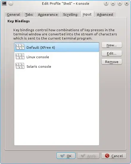

Konsole is a terminal emulator for KDE that provides relevant option, in which can be configured to use Page Up and Page Down keys for direct paging. There are no other terminal emulators that I found as easy as Konsole for such customization.
How to direct paging
In Konsole, do the following steps.
  1. In menu bar, go to "Settings" and click "Configure Current Profile..." (Kubuntu 12.04) or "Edit Current Profile..." (Kubuntu 16.04) and a window will appear.
  2. Click on "Input" tab (Kubuntu 12.04) or "Keyboard" tab (Kubuntu 16.04), which has a section called "Key Bindings" with predefined lists of key bindings.
Key Bindings in Konsole
  1. Select "Default (XFree 4)" and click "Edit..." button, then another window will appear.

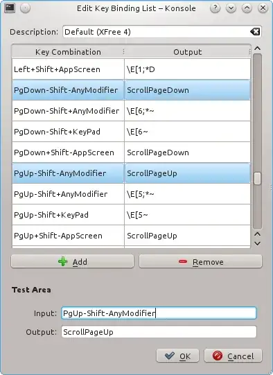

  2. Scroll down and look for key combination PgDown-Shift-AnyModifier with output \E[6~. Rename this output to ScrollPageDown.
  3. Scroll down and look for key combination PgUp-Shift-AnyModifier with output \E[5~. Rename this output to ScrollPageUp.
  4. Click "OK" button to finish and close the windows.
How to test output
In step 3, there is "Test Area" to confirm the output for each key press.
  • Click to bring focus in "Input:" text field and press Page Up and Page Down keys (one at a time).
  • Confirm the output to be the same as renamed ones.
    Key Bindings List and Test Area in Konsole

Bonus: Key combination and output
Alright, bonus answer for clarification. One may wonder why I had to edit those key combination and not others. I had figured that out earlier by testing several types of keyboard.
The following are default key combination and its output, which have been figured out using "Test Area" in Konsole.
For primary Page Up/Page Down keys (including keyboard variant that requires to press Fn key a.k.a. Fn+PgUp/Fn+PgDn):
  • Key combination: PgDown-Shift-AnyModifier Output: \E[6~
  • Key combination: PgUp-Shift-AnyModifier Output: \E[5~
For secondary Page Up/Page Down keys (default shortcut in terminal that requires Shift key a.k.a. Shift+PgUp/Shift+PgDn):
  • Key combination: PgDown+Shift-AppScreen Output: ScrollPageDown
  • Key combination: PgUp+Shift-AppScreen Output: ScrollPageUp
Notice that minus - and plus + signs differ between each keywords for primary and secondary keys. Those are how key presses are translated into equivalent characters, at least in Konsole.
